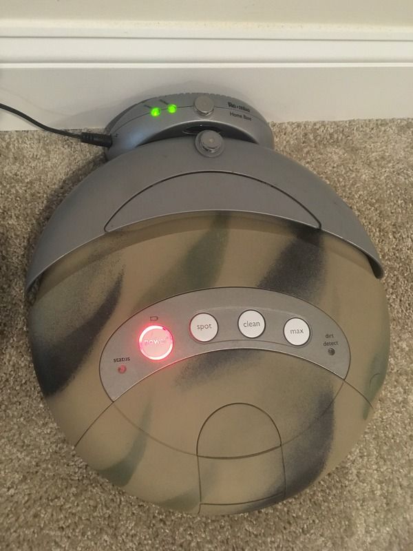

It's certainly not relevant but everybody loves pics so here you go. I'm calling him Commando B.O.B. (Bug Out Bot).
smithb

Postby vic7767 » December 6th, 2017, 5:20 pm
Nice color scheme on your bot. To get that non-BiTs Scheduler to co-operate may require dis-assembly to access the User Interface buttons and clean out the built up dust bunnies and other debris.

Postby smithb » December 6th, 2017, 8:26 pm
Thanks, vic7767. Tiger stripe camo is my old standby. I just threw it together quick and dirty like, so I’ll probably revisit it at some point and put some more effort into it. To do the paint job I removed the button pcb and cleaned the whole area inside and out. I have another button pcb laying around in preparation for another paint job so my next step will be to try it with just the pcb and no cover.
My 5 year old daughter wants hers to have the same scheme; just in shades of pink and purple. Should be interesting.
