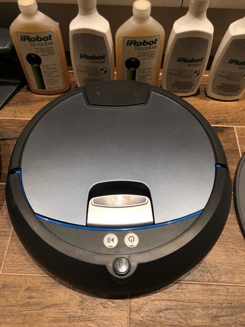

In other news, I just ran the 390 for the first time ever. Did a pretty good job except it didn’t pick up any of the water lol. The dirty tank was bone dry at the end of the cycle.
Could well be that I need to deep clean the internals, or maybe something was aligned slightly off when I put it together. This is the first time I’ve ever so much as seen a Scooba in real life so I’m hoping it’s my ignorance rather than anything more serious. I read a couple of the old threads here from people with that problem and they ended up in discussions about heating the plastics and remodelling the parts. I’m diastaser-prone, so no way I’m doing that.

Your Scooba tank with the clean & dirty reservoirs may need to be soaked with hot soapy water and then with both flaps closed shake the "good grief" out of the tank and then empty them. You should hear a flapper ball rattle when you shake. If you don't hear the flapper, repeat the earlier steps until you do. Then your Scooba should deposit the dirty water into the dirty tank. Possibly fill 1/3 to 1/2 of the tank.

So I gave the whole tank a really good clean - soaked it in warm water and vinegar then blasted warm water through it at a high rate, then ran another clean. There was a fair amount of water left on the floor, about as much as if you hand-mopped and the dirty tank picked up water this time. I emptied out about a cup or two’s worth of the stuff. Does that sound about right? I don’t really have a sense of how wet it should leave the floor or how much dirty water I should expect to come out at the end.

That amount of fluid is just a little low. Main improvement may come from a new set of squeegees. In a non-humid home the water left on the floor by a Scooba should dry within 15 minutes.
