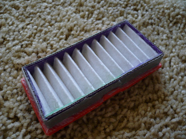

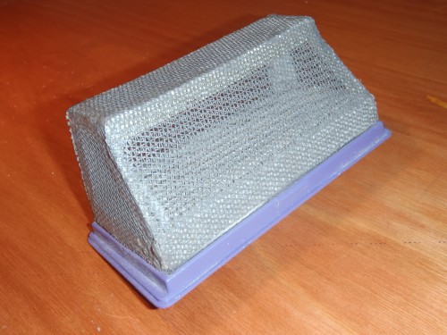

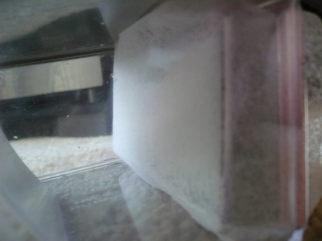

So being a tinker by nature, I set about making my own HEPA filter.
Here are the pics of Neato HEPA v1
Basically I cannibalized a HEPA filter off my black&decker cyclone vac. 1 filter yields enough material for 2 neato filters.
Then I used silicone and some thin cardboard to seal the edges.
lastly I fixed a fine semi rigid insect mesh over the top as a form of prefilter to prevent large debris from choking up the airflow.
Testing it made made one thing clear:
neato is limiting the suction power of the fan on purpose by design. because of my filter, my resulting airflow is estimated to be twice that of a normal clean original neato filter. and the neato stopped working with an error message asking me to check the bin because it thinks I left the filter out!
I had to place paper and oil filters to obstruct the airflow enough for the neato to work properly (estimated blocking off 60% of the airway)
noise wise, I would say there's not much difference. us neato users are quite used to the sound of its vacuum.
talk about hardware potential!
it's like operating dual i7 hex core CPUs with only 2gb of ram without any heatsinks.
Hope you guys find this useful. :thumbup:
:arrow: If the neato folks are reading this, pls pls pls pls give me a firmware with the air flow limitation removed so I can see how this baby can fly. :mrgreen:

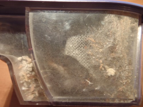

piokrza wrote:Interesting idea! :thumbup: I'm curious how you gonna clean the space in between the mesh and hepa :D
Well since I've been cleaning my office so often there wasnt enough dust, so I sent it to clean the outdoor corridor instead.
The amount of crap I collected was crazy but the airflow was good throughout. But I guess if I were to go to the extreme, I've to think of how to mount an anemometer to the exhaust to measure the airflow.
Turns out most of the dust that gets past the mesh comes back out with a few taps from behind.
I'm still at crossroads about designing a fully disposable filter or semi disposable (more durable). But I'm leaning towards the semi disposable option due to the long life of the HEPA filter material.
Maybe v1.1 I'll make a removable mesh to aid fine particle removal.

Postby mtbook » August 28th, 2011, 5:25 pm

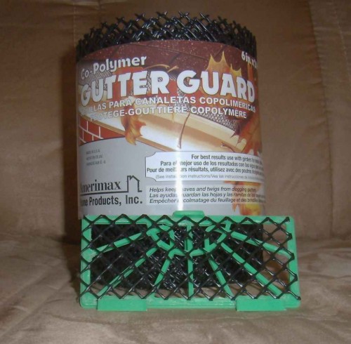

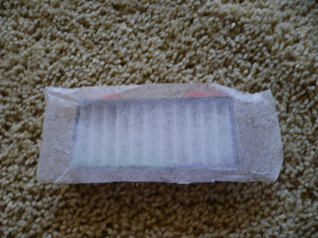

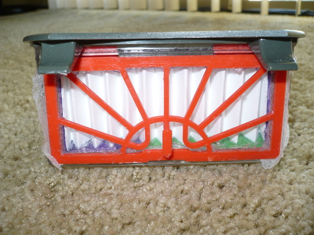

Thanks for the great idea! I spent the weekend building my own HEPA filter and, after some trial and error, am very happy with the results.
Since I wanted to have a removal prefilter, I decided not to add any metal grating but instead use dryer sheets. I drape the dryer sheet around the filter before I snap it in which locks the sheet in place. It's cheap and does the job pretty well. I go for the non-scent ones but you can just as easy make your home Bounty fresh :-)
Edit: Pictures!
Silicone sealant does a fantastic job air-sealing the filter to the cardboard frame (thanks for the tip, I would have never thought of using that)
Dryer sheet, cut in thirds
When the filter snaps in it clamps the dryer sheet in place
Dryer sheet snug against the HEPA filter
