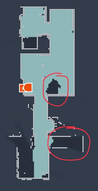

yes, i got the update and it asked me to run a special floor mapping cycle for the first time, which I did and it still avoided the problem area as it had previously been doing, even though the area was empty and clear.
This was the report it delivered after the mapping run. The area circled bottom-right is the area it always avoids. The area circled in the centre was totally clear, although some days previously there were some clothes hanging on a drier there which would have obstructed it. When this run was conducted that area was totally empty and clear.
