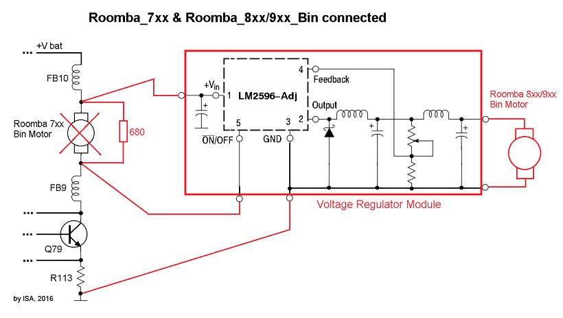

How did you handle current limit for the BLDC bin motor?

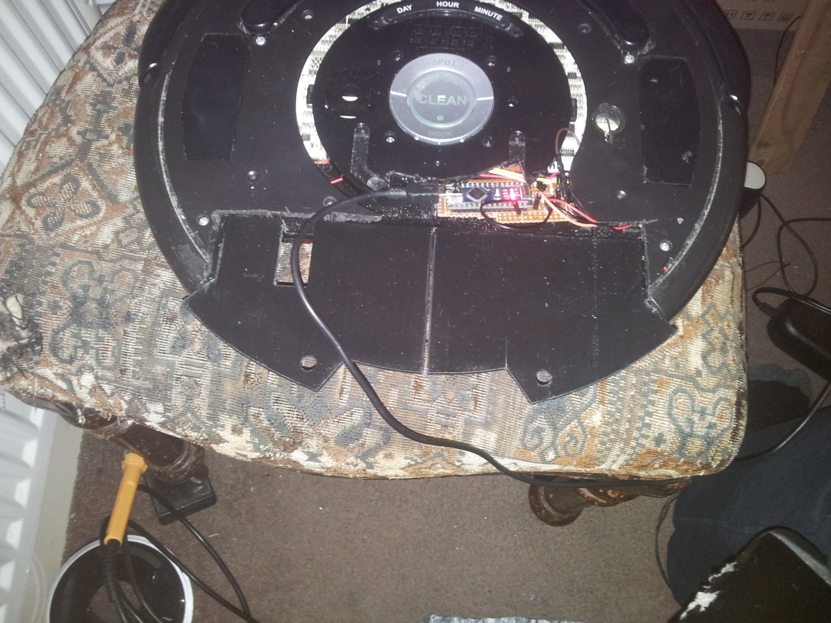

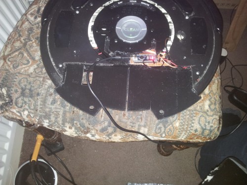

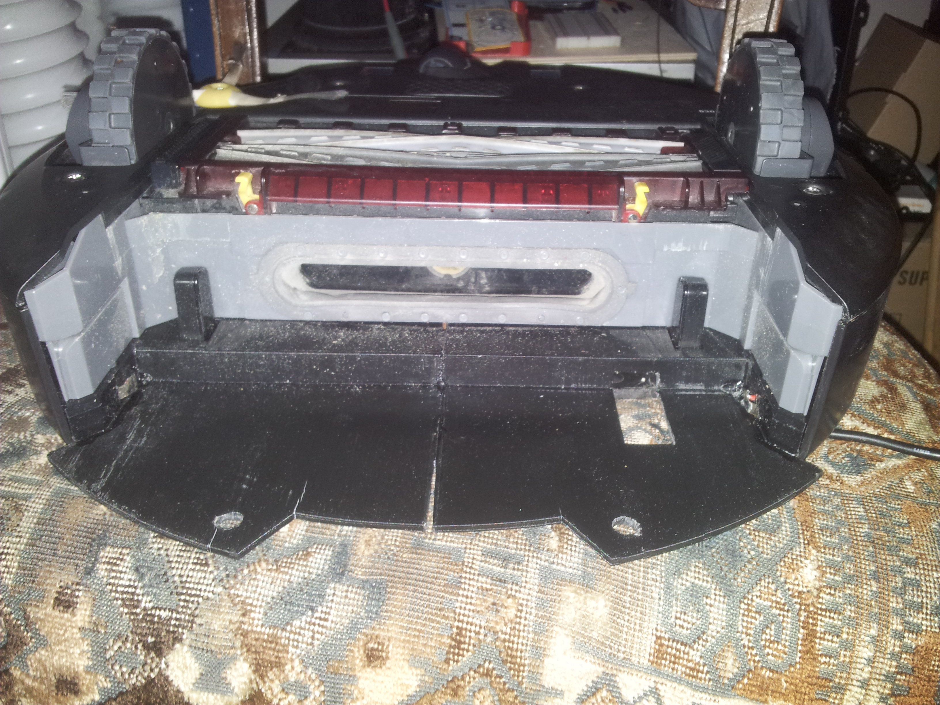

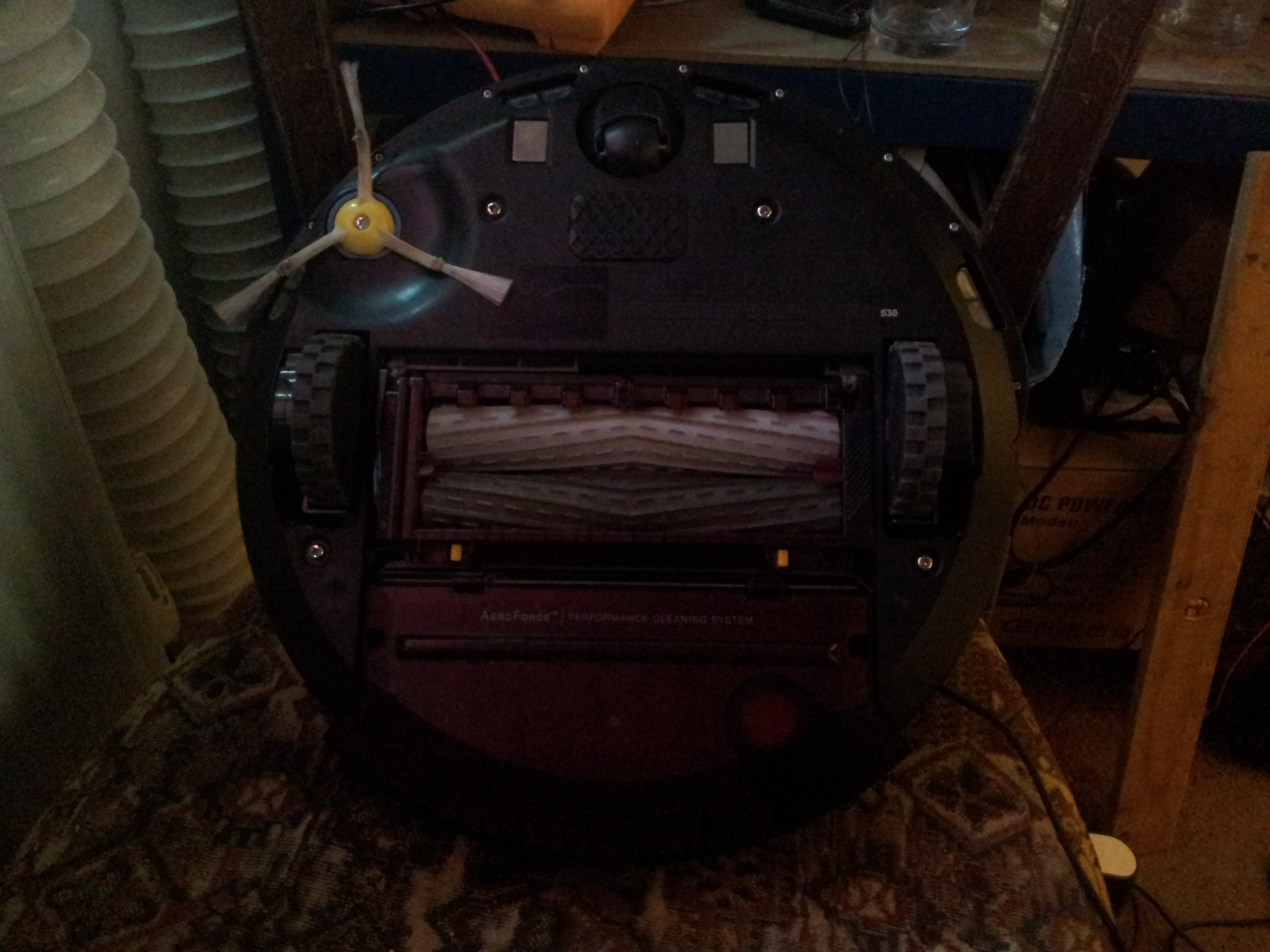

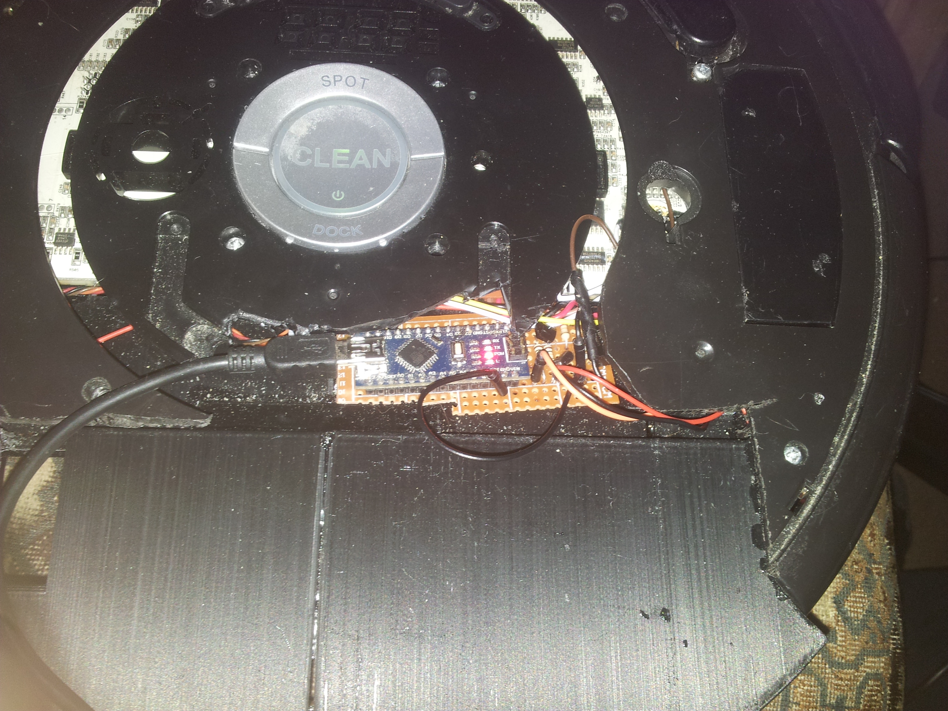

Postby LazyRoomba » July 29th, 2016, 2:04 pm
The CHM had no modifications made to the electronics, but does require milling, or cutting a big piece of the chassis off. The dirt bin is the same. The roomba will not power the dirtbin as it draws too much current, so..
I used a cheap $0.01 pnp transistor and a mosfet. Buck convert on ebay for around $2. Then the big task, and risk, was cutting up the chassis and redesigning the backend, which I 3D printed and glued in place.
The dirtbin circuit.
http://prntscr.com/bz5sz0
Added pics of the roomba itself.
Curerntly working on a project that will use the nano sat in the roomba to control the robot with new modes, such as cleaning ect.. (Smarter, room mapping ect..) hence the missing serial port (Removed for a discrete look)
Been using the roomba with the 880 mods for nearly a year, been running perfectly fine

Postby a1robotrepair » July 29th, 2016, 4:58 pm
That's 3 I know of.
My 780 using third-deg chassis mod. and shorting R113, adding heat sink to Q79 and a small separate board for a low pass filter. http://www.robotreviews.com/chat/download/file.php?id=8573
Zs 760 using a stand alone V to V converter and Q79 as control.http://www.robotreviews.com/chat/download/file.php?id=8596&mode=view
And yours, the most extreme mod to date.
If you get your hands on an OSMO and get familiar enough with your Adriano coms, you will be able to read more than the makers want. Warning, don't post findings as Gregg found out, posted in his scratchpad.
