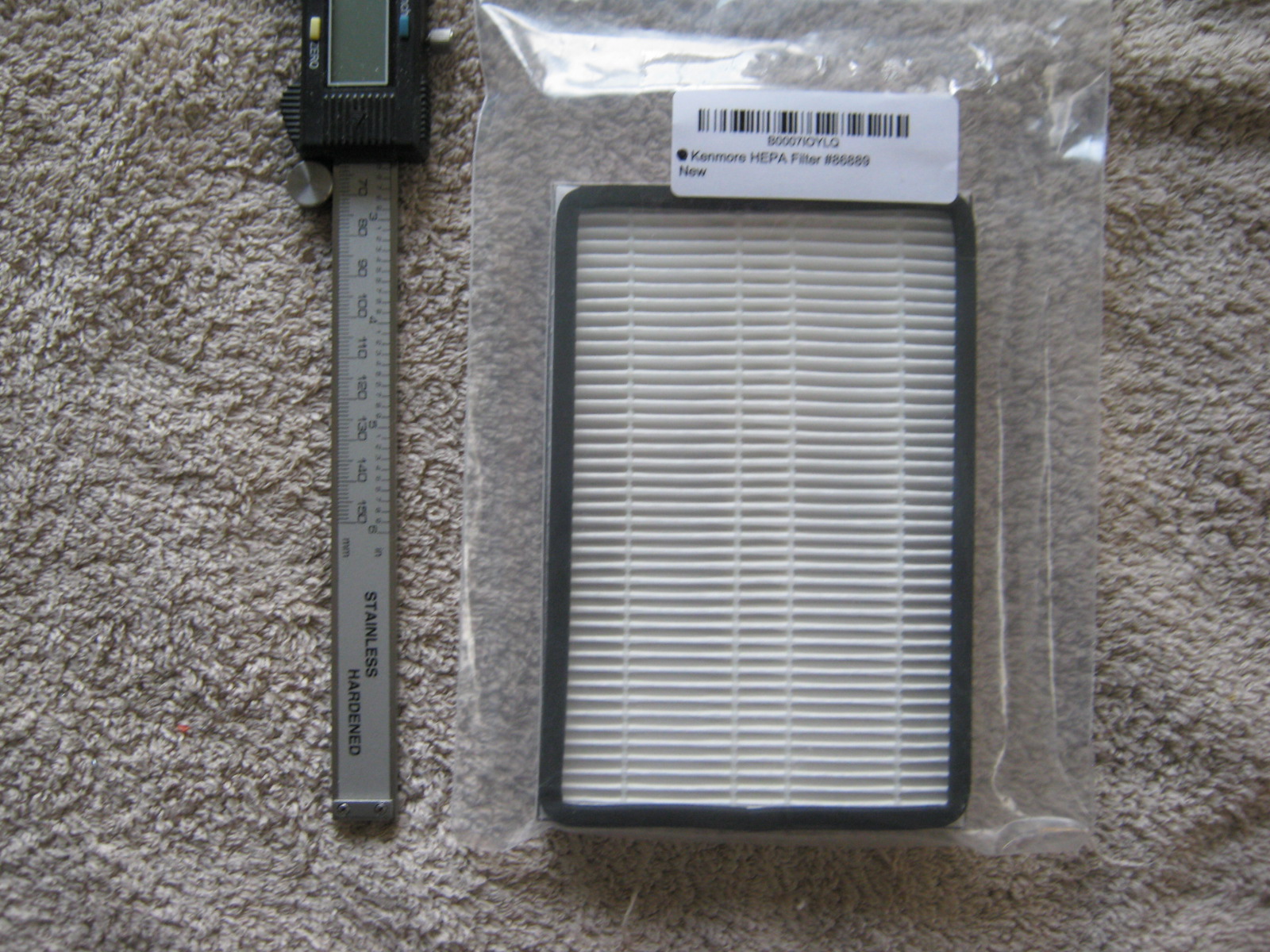

cant see the pics from imageshack..mtbook wrote:Thanks for the great idea! I spent the weekend building my own HEPA filter and, after some trial and error, am very happy with the results.
Since I wanted to have a removal prefilter, I decided not to add any metal grating but instead use dryer sheets. I drape the dryer sheet around the filter before I snap it in which locks the sheet in place. It's cheap and does the job pretty well. I go for the non-scent ones but you can just as easy make your home Bounty fresh
Edit: Pictures!
Silicone sealant does a fantastic job air-sealing the filter to the cardboard frame (thanks for the tip, I would have never thought of using that)
Dryer sheet, cut in thirds
When the filter snaps in it clamps the dryer sheet in place
Dryer sheet snug against the HEPA filter

The issue I see with the pre filter is you lose most of the surface ares of the folds of the hepa filters and it will clog much quicker than the hepa filter.
Re: neato HEPA filter DIY mod v1
I agree, the pre-filters defeat the purpose of having a HEPA filter - i've found a couple of wertiem style HEPA filters on eBay that look like they'll work well in a Neato. They have the fins much more densely packed together than the filters used so far and so should be interesting.Las Vegas wrote:The issue I see with the pre filter is you lose most of the surface ares of the folds of the hepa filters and it will clog much quicker than the hepa filter.
Pre-filters are much more permeable than hepa filters, so much so that the pressure drop of adding one is negligible, Fick's Law and all that. All of the air purifiers and vacuums I've owned use pre-filters (ie. vacuum bags) as a way to prolong the life and ease the cleaning of the typically much more expensive hepa filter.Las Vegas wrote:The issue I see with the pre filter is you lose most of the surface ares of the folds of the hepa filters and it will clog much quicker than the hepa filter.

MT book, I understand that a hepafilter is not nearly as permeable as the prefilter but the hepa filter has infinitely more surface area than the pre filter. That dryer sheet will clog much more quickly despite its larger pore size than the hepa simply due to the smaller surface area. Many prefilters you see have much larger pore size than a dryer sheet to catch larger debris.

YMMV. Even after a few days of not emptying the bin, neato (on 2.1) will still tell me it doesn't detect a filter, which seems to indicate the resistance is pretty low with the prefilter+HEPA. Most of the stuff I pick up in my home is fine dust and random fiber debris which is pretty fluid and doesn't really act as a solid object blocking the filter.Las Vegas wrote:MT book, I understand that a hepafilter is not nearly as permeable as the prefilter but the hepa filter has infinitely more surface area than the pre filter. That dryer sheet will clog much more quickly despite its larger pore size than the hepa simply due to the smaller surface area. Many prefilters you see have much larger pore size than a dryer sheet to catch larger debris.
I originally considered putting an air purifier charcoal prefilter in the neato but the handful I own are at least a centimeter thick.

I've already removed the oem material from a used filter (that was harder than I estimated!) and now I'm just waiting on my HEPA filter to arrivemtbook wrote:Awesome! Can't wait to see picturesdjos wrote:I grabbed one of the below HEPA filters from eBay, should be a fun project.
