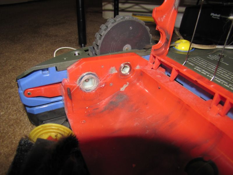

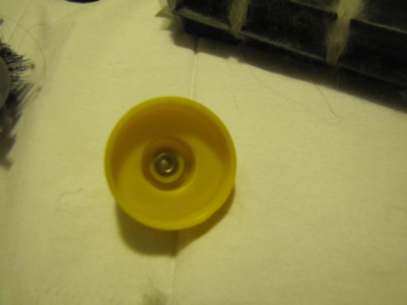

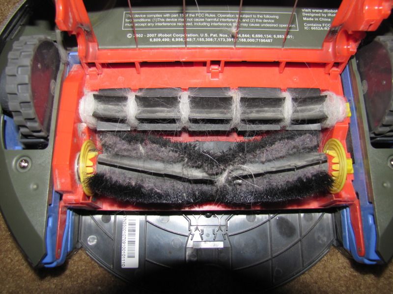

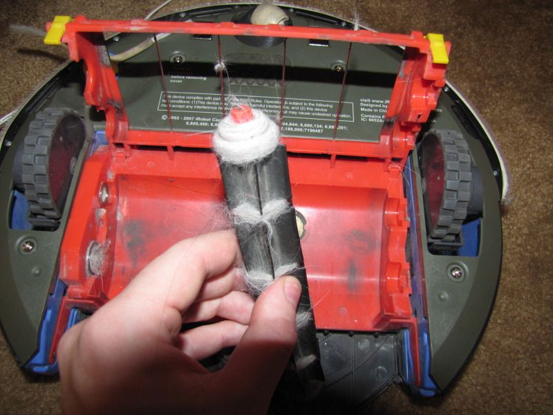

The Image bellow shows what the redCHM, and brushes looks like after a cleaning run at my apartment. (This was run for about 30 min as I am trying to revive the battery, but it’s a good representation for comparison)
CHM from top

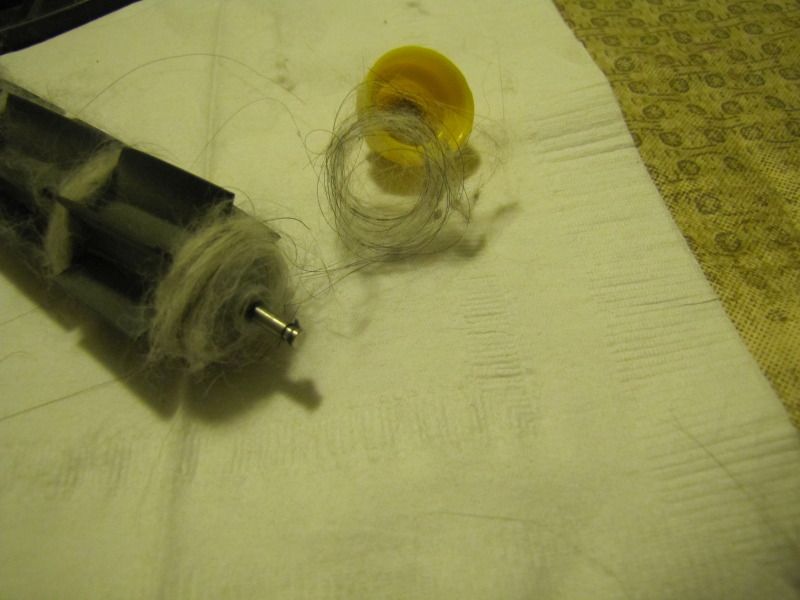

Typical hair build up on the connection edge ( there is similar amount under the bearing side as well)
The Side where Brushes enter the gearbox, you can see hair being compressed against the bearings(those are about 1 year old.)

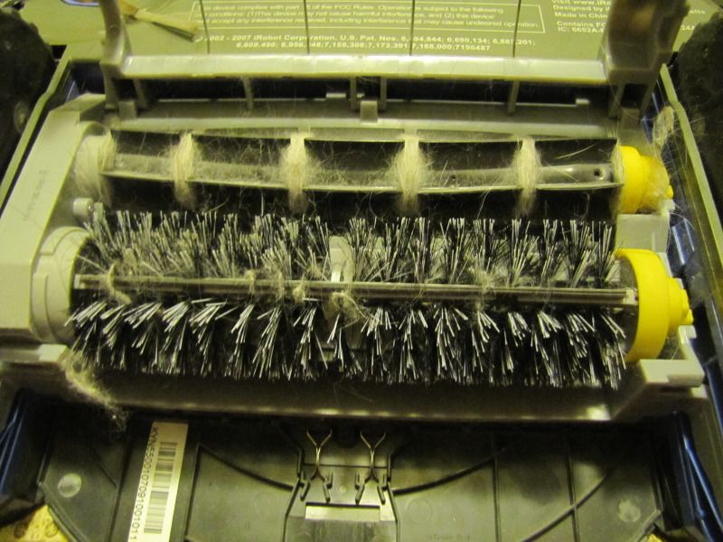

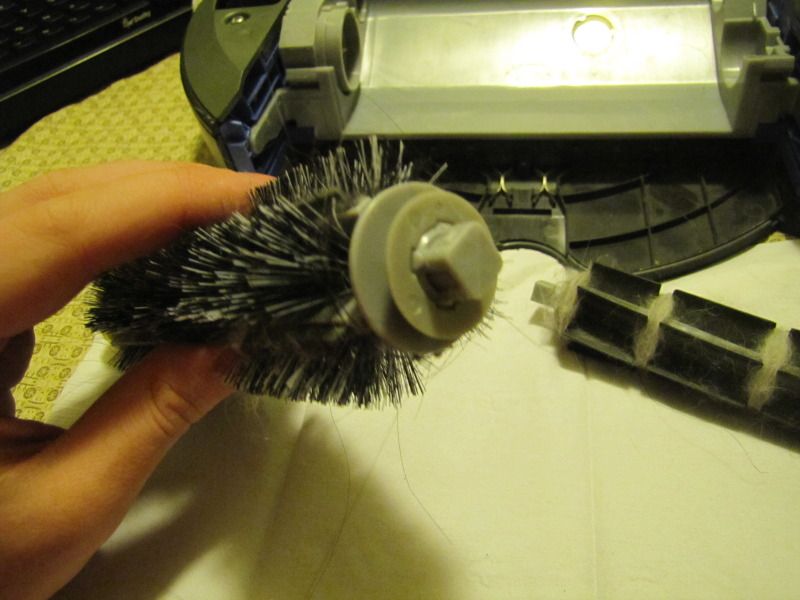

Bellow is what the 700CHM looks like in my 560 after running for about 40 min at my apartment.
Here is what the 700CHM looks like from top after cleaning.
Hair at bearing side, which there is not as much as usual, especially human hair is very limited in buildup. It is also ALLOT easier to clean those then the red brushes
Bearing condition of the big bristle brush ( no cleaning was done before taking pictures)
Bearing condition of the beater bar, lots of hair built up on the fat side of the cover, not as much hair was between the short section and on the metal pin it self (this seems to cure a problem where hair will wind up on metal pin and push the bearing out, causing increased friction and CHM failure)

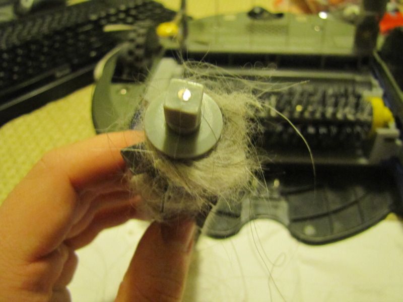

Now on to the Side of the CHM gearbox, not much hair was built up around the gear area and on brush ends
Bristle Brush
Beater Bar
The gear opening, there was very little hair but it seemed to be entering the gear box.

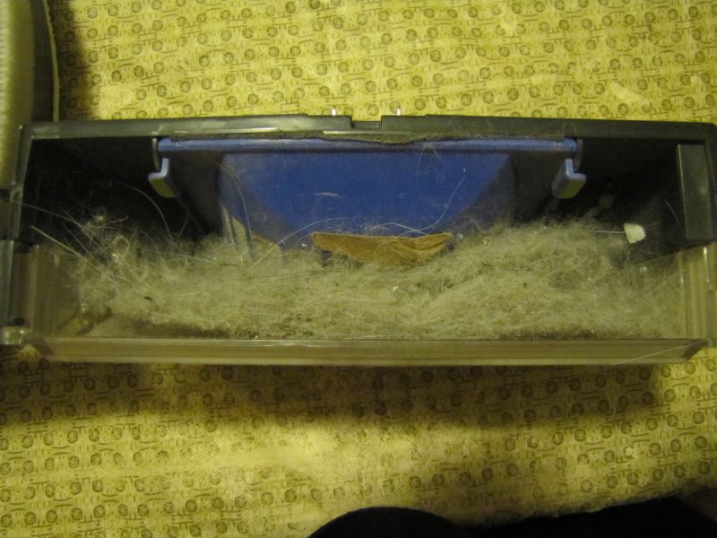

The brushes cleaned with crap that was on them
The AeroVac 1 bin filled with crap
The Crap
