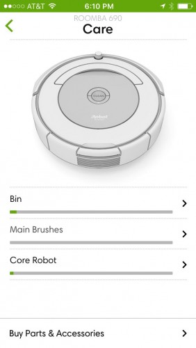

Re:iRobot APP info for the 690
Here are some iOS image captures of the iRobot APP pages:
