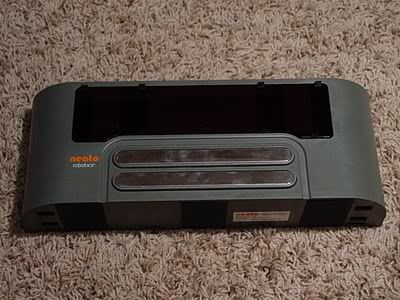

Here is a picture of the unit, camera flash not used

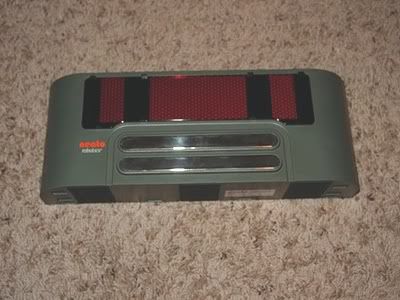

Here is a picture of the unit, camera flash is turned on

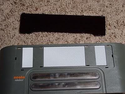

Here is the unit with the filter (probably IR) removed.
I thought how cool is that!! Using the reflections from the charging base as a sort of LIDAR bar code! This thing just keeps impressing me! It will be interesting to look at the raw data output from the LIDAR to see how the signaling is coming across. At first glance it appears that the signal strength data will contain this info.

fake said...
That silvery material is called "retroreflector". It's the same thing used on road signs and safety vests. What is neat about retroreflector is that it sends light back in exactly the direction it came, with very little loss.
In this case, it means not only will there be the pattern showing up brightly, but the directional aspect means that it will be the brightest thing in the room for a certain set of angles -- which is to say in the direction of the charger.
November 29, 2010 11:33 PM
Hash said...
Thank you for the clarification. I noticed the reflective properties as I set the charger in my test setup. Signal strength readings were VERY strong.
