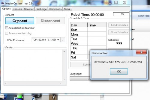

Postby lurch » March 22nd, 2015, 4:06 pm
This program is awsome!
I use it connecting to a Botvac 85 which I recently added with a small arm linux board (Arietta G25) so I can now connect to the bot through wifi.
Unfortunately NeatoControl does not offer a network connection like telnet, only through local COM ports. I installed ser2net on the linux board so I can telnet to it and use the terminal as if it was a local terminal connection.
I tried using several virtual COM port redirectors on the windows computer that runs NeatoControl that would create a virtual COM port and rediret it through telnet to the real device. If I select this virtual com port in NeatoControl, sometimes it works for a couple of seconds but then stops with an error "Empty read". I presume this is some sort of a timing issue.
Any ideas on this or do you plan to add support for network connection to the Neato?
Thank you for your hard work,
Martin

Postby vic7767 » March 22nd, 2015, 4:27 pm
I've already run into that same error using a setup similar to yours. I emailed heX and sent the same error info to him. I asked if he could add a TCP/IP connection. So far there seems to be a protocol issue between UART serial and the NeatoControl program.

Postby glnc222 » March 22nd, 2015, 5:50 pm
Not a Windows I/O expert but in case of use:
When Neato USB is connected to a PC instead of an extra WiFi interface in the Neato, the Neato Robotics driver creates a virtual com port to use the USB. What that consists of can be seen in an alternative driver once posted at RandomWorkshop and removed but saved here under Roomba http://www.robotreviews.com/chat/viewtopic.php?f=4&t=17580
Some other USB driver must operate inside the WiFi device.
Since the Neato is echoing every character in terminal emulators it appears unusual single character USB packets are used, tacked onto an old serial port system in the Neato -- older system boards had a serial header on the board which could be used, removed in later boards. Older AMD/Nvidia PC's, compared to Intel based, had some defect in the chip set drivers which would not work with the Neato driver, compared to Intel, never fixed because no other devices affected, presumably because they used more standard USB protocols, packets. Bottom line is that the USB interface in the WiFi host mounted in the Neato must support the USB interface the same way as a PC. So needs specialists in that equipment.
[edit] Using WiFi there are issues in the WiFi driver as well as in the USB driver inside the Neato.
When the alternative Randomworkshop driver is installed in a PC, the Neato Robotics firmware update web site cannot see the Neato, presumably because it looks for the specific driver from Neato instead of merely the USB device ID. Perhaps this is why it was removed from the web. USB commands, however, work. The company driver works the same anyway.
As the firmware updating website now works with registered serial numbers to select the proper version, and there is no update for Botvac, to obtain the PC driver it might be necessary to use a direct link to the driver page:
64-bit: http://www.neatoroboticsupdates.com/NeatoInstaller/NeatoUpdaterToolInstaller_x64.exe
32-bit http://www.neatoroboticsupdates.com/NeatoInstaller/NeatoUpdaterToolInstaller_x86.exe
(In Window 64 bit, a global Windows setting must be made in the system troubleshooting menu to allow installation of unsigned drivers on a PC; instructions on the web)

Postby lurch » March 23rd, 2015, 8:16 am
I see your point that the original Neato driver behaves differently from that fiddly interface I created by connecting a Linux usb host to the Botvac and then relay it through wifi.
However, as far as I understood, all the NeatoControl software has to do is to send and receive ascii characters through the interface and this actually works quite well, just the timing is different (time needed for a charachter to be received by the other side).
While I am not aware of how this great software was implemented, I presume it just takes the timing behaviour of the original drivers for granted. So I was thinking if it could be changed i.e. by using buffers to allow for transmission delays that will occur if you send them through a tcp connection over wifi where some packets / characters will havo to be sent several times until they are acknowledged.
lurch
Posts: 10
Joined: March 22nd, 2015, 4:43 am
Re: NeatoControl - program for diagnostic neato robots
Postby glnc222 » March 23rd, 2015, 1:31 pm
I may misunderstand but you seem to imply the Neato Control Program communicates in some stand alone manner with the USB instead of in the normal way as part of a Windows operating system. Applications in windows communicate through drivers and I/O layers built into the OS. (There is quite a fancy manipulation of this for real time apps like games and music synthesis, where the multi-tasking system is modified to reduce latency, bypassing various buffering and what not, using special drivers and OS features). The Neato Control Program calls upon drivers the same way as other apps in Windows and operates same as a terminal emulator, just generating and parsing all the text msgs. The comm is all done by the specific Neato driver, which in turn relies upon the system chip set drivers for lowest level details; some big I/O IC supports the USB interface, listed as USB controllers in Device Manager. At some point protocols built into dedicated IC's for USB interfaces or equivelents in microcontroller firmware govern the bit level aspects of USB packet protocols. They negotiate bit rates with each other etc., determine revision levels etc., acknowledgements, handshaking etc.
I seem to recall here a number of successful interfaces of microcontrollers to the Neato USB (threads listed in the mods list index post main page).
What is involved when Neato Control goes through a WiFi interface on the PC is not clear, as this is a different system than the USB drivers? Lot of mapping going on in the OS here.
I would think at least testing can be done of the microcontroller separate from the WiFi, through some other port on the controller hardware, to isolate WiFi effects.

Postby vic7767 » March 24th, 2015, 10:16 am
heX, thanks for the addition of the TCP/IP selection, I do believe that in order to test this new feature will require adding a port number to the IP address. ex; 192.168.10.1:3696
Here is a screen print of the TCP/IP + port number error

Postby heX » March 25th, 2015, 1:34 am
vic7767 wrote:thanks for the addition of the TCP/IP selection...
Try port 2167 - its raw telnet port. (http://www.get-console.com/faq/?secid=12)
Also enter this commands in system command line:
ping 192.168.10.1 (just for test)
telnet 192.168.10.1 2167 (if telnet connected successfully then try send command "help".)
heX
